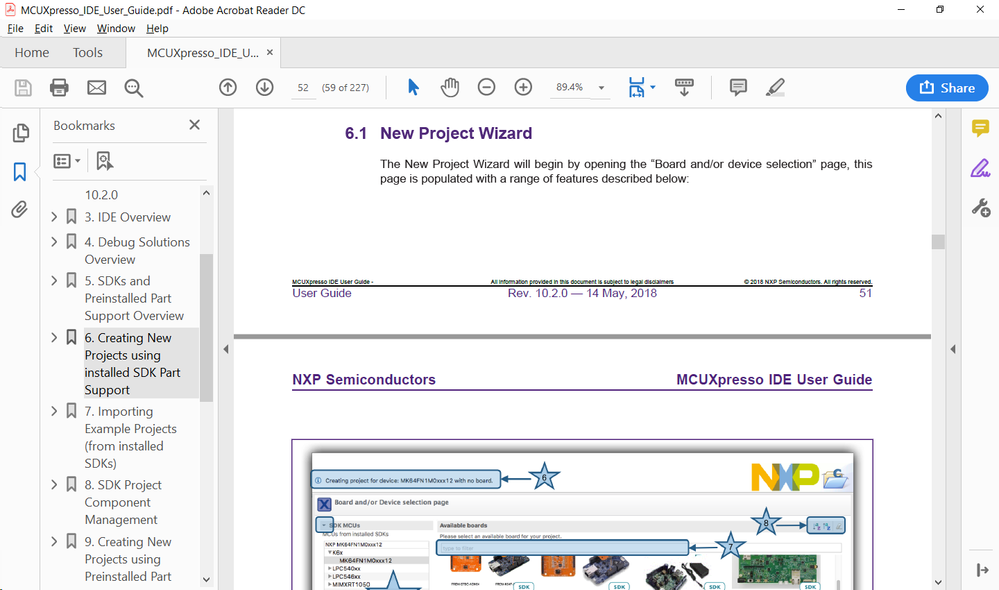

Hi OGAWA:
Please refer to the MCUXpresso_IDE_User_Guider.pdf.
Chapter 6, Creating New Projects using installed SDK part Support.

ogawatakeshi
Hi Daniel.
Thanks for reply.
I'd like to know new board sdk creator.(not new project create.
Is it possible to (New/Board SDK Wizard create) new board SDK?
