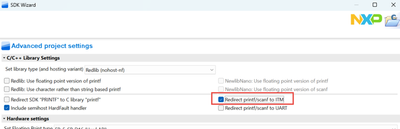

1) When creating a new project, select “Redirect printf/scanf to ITM” to redirect printf/scanf to ITM.

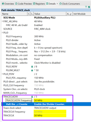

 2) Configure the Trace clock:
/*!< Switch TRACE to TRACE_DIV */
CLOCK_AttachClk(kTRACE_DIV_to_TRACE);
/*!< Set up dividers */
/*!< Set TRACECLKDIV divider to value 3 */
CLOCK_SetClkDiv(kCLOCK_DivTraceClk, 3U);

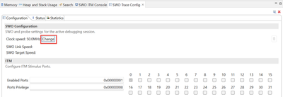

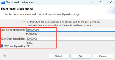

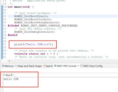

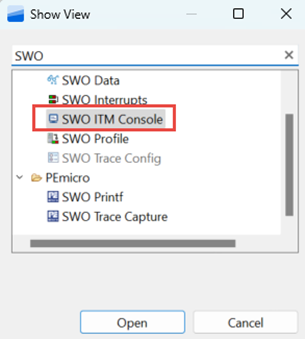

 3)In MCUXpresso IDE, open the SWO ITM Console and configure Core Clock and Trace Clock settings.
4)View the output results in the ITM console.

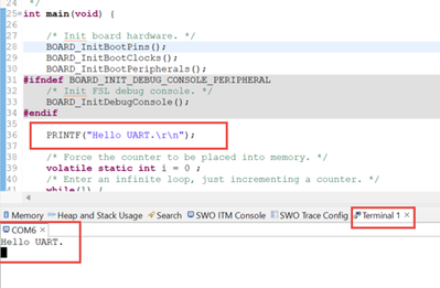

3.2 Using UART Printing

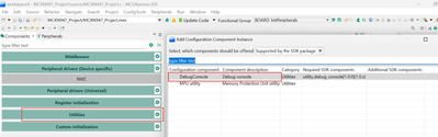

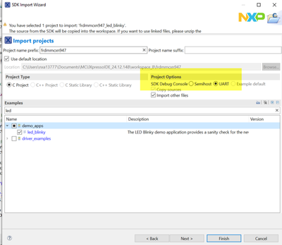

1)When creating a new project, select SDK Debug Console to UART to set DebugConsole to use UART.

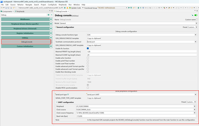

2)Use MCUXpresso IDE’s peripheral tools to configure DebugConsole-UART. Alice_Yang_13-1764646149103.png Alice_Yang_14-1764646156564.png

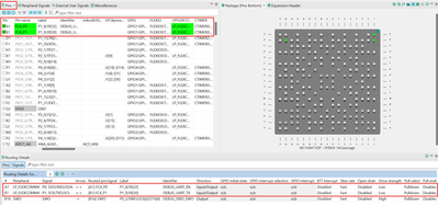

3)Configure UART TX/RX pins using the Pins tool. Alice_Yang_15-1764646165004.png
4)Connect the serial hardware and view the output results in a terminal. Alice_Yang_16-1764646174816.png
