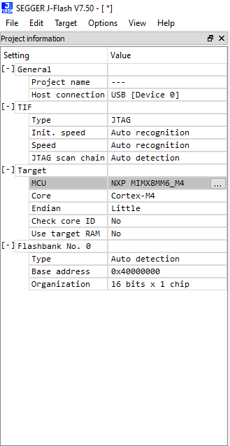

martindenion
Hi!
I am also trying to program the Cortex-M4 of an i.MX8M Mini.
From the J-Flash software, I'm able to connect in JTAG via a SEGGER probe but my debug configuration doesn't work. My goal is the same as you : debugging on the Cortex-M4 from MCUXpresso IDE (or from any other Eclipse IDE). Can you send me your configuration please ?Capture.PNG
