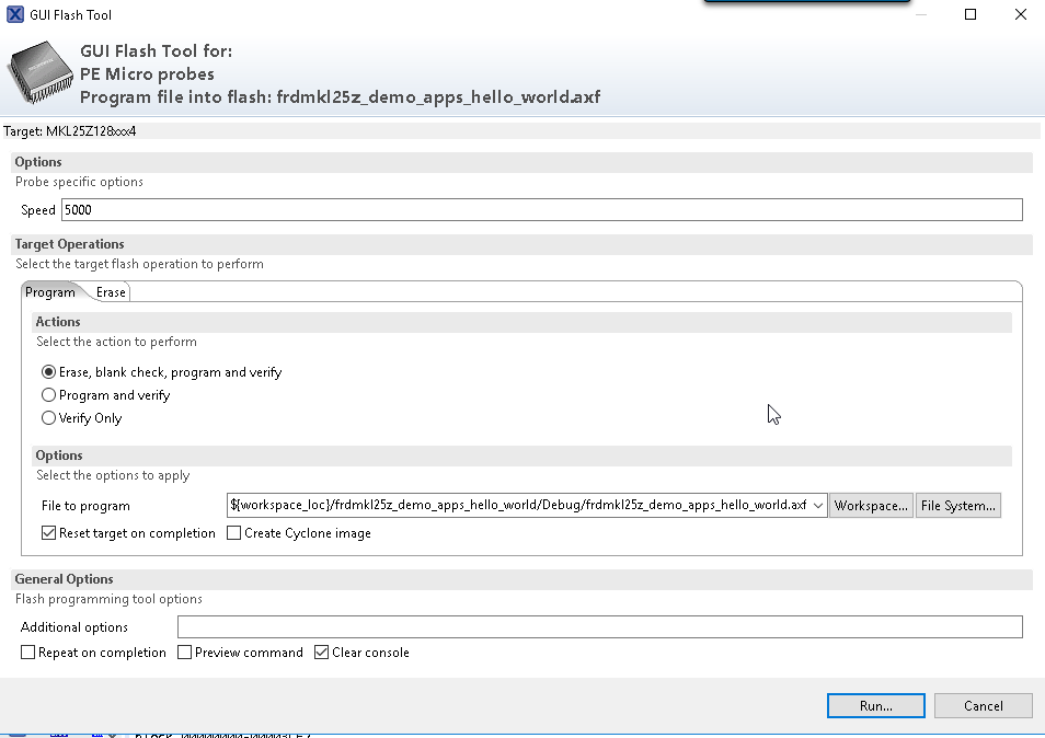

Hi guys,
I'm new here and  new with the freescale platform as well. So, I'm just trying the basic "Hello World!" code,but I'm having some troubles. I can debug it normally, but when I try to use 'the GUI flash tool' using the connected probe I receive this result:
Device selected is NXP_KL2x_KL25Z128M4
User Specified Hardware Selection : Interface=OPENSDA and Port=USB1
Connecting to target.
OpenSDA detected - Flash Version 1.18
Device is NXP_KL2x_KL25Z128M4.
Mode is In-Circuit Debug.
(C)opyright 2012, P&E Microcomputer Systems, Inc. (www.pemicro.com)
API version is 101
Creating kernel driver for freertos
Server 1 running on 127.0.0.1:7224
Server 2 running on 127.0.0.1:7226
Server 3 running on 127.0.0.1:7228
Server 4 running on 127.0.0.1:7230
Server 5 running on 127.0.0.1:7232
Server 6 running on 127.0.0.1:7234
Server 7 running on 127.0.0.1:7236
Server 8 running on 127.0.0.1:7238
Server 9 running on 127.0.0.1:7240
Server 10 running on 127.0.0.1:7242
Warning: No data was programmed in FLASH
All Servers Running
Target Disconnected.
Basically, it's not saving my work.
Could someone help me with this?

Hello Judá Santos ,
Please tell me which board do you used? And also the MCUXpresso IDE version, please use the latest v10.2.0.
The "13. The GUI Flash Tool" of <MCUXpresso_IDE_User_Guide.pdf> introduce how to configure and flash ,
you can have a look , I attachec it for you.

Hello  Judá Santos .
Which board do you used ? For example FRDM-KL25 ? Or  a custom board ?
I test on FRDM-KL25 board, it can work well . On my side , the GUI Flash Tool for P&E probe is :

juda-santos
I'm using a FRDM-KL25Z. I tried the same as you showed, but I got the same result as before.
The weird thing is that I can use this board normally in a PC in my university, but I can't use it at home.
Anyway, thank you for your help. (:

Hello Judá Santos,
What about the system version of your home ?
Please uninstall the P&E driver on PC, then reinstall it again.
