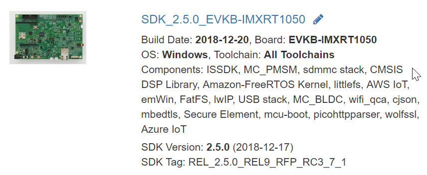

I checked the latest MCUXpresso SDK for EVKB-IMXRT1050  version is 2.5.0
I only find the [rtwdog] driver example.
Could you please check here to download the latest SDK package and check if there still with the same issue.
Please let us know the result.
