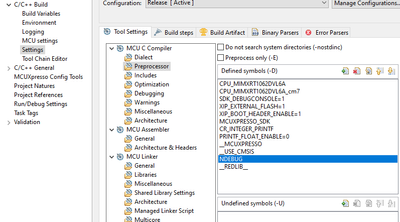

Would MCUXpresso have a #define that it sets depending on whether a build is a debug or a release version?
I'd need to have slightly different build versions for debugging on EVK boards versus the true Release version for target hardware.  I keep forgetting!  It seems not unreasonable that some #define might already exist that would allow conditional compilation to differentiate between debug and release - without relying on fallible mortals....  Can try to set something up myself, but it wouldn't surprise me that something already exists.
Thanks for any pointers!
3,618 Views
dougpaulsen
Never mind.  I found it!  It's DEBUG and NDEBUG.  See project->properties->C/C++ General->Paths and Symbols.
3,608 Views
danielchen
NDEBUG /DEBUG also in MCU C compiler preprocessor.
