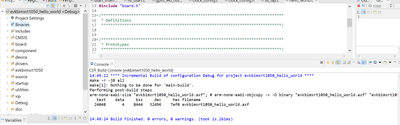

Hello. Im trying to use the example projects for the usb_video_virtual camera device for the MIMXRT1050 evaluation board. I have not modified anything in the code but when I compile it it has several errores mainly with some includes that ARE in the folders and in the path but still not compiled or included.
I have tried with other example codes such as the Hello world but still got the same error.
Can somebody help me please?:( is my first time using this board.

FINALLY SOLVED THE PROBLEM. Im using a computer from my company so Im not the admin user I just logged as a guest with my email, etc.
The problem with this is that while selecting the location for the workspace and stablishing in the Desktop or documents for example (im using windows) the compiler needs to enter to a very long path for accesing the files, such a thing like C://users/myuser/Desktop/folder/workspace/anotherfolder/...... and so on. So the compiler seems to have problems with this long paths and adding the fact that it does not hace admin permission for entering some parts ( Not exactly sure about the exact reason for the problem, but the fact that is due to the long path).
I actually got a really similar error while working with STM32 MCUs.
The way to solved is to set the Workspace directly in the Local Disk C folder so the path is as short as it can be.
Hope that this can help anybody.

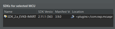

How about use the latest SDK 2.11.1 and MCUXpresso IDE v11.5, I test it on my side, there is no error.
Alice
6,245 Views
Ismael_dz
Im using exactly the version that you menctioned.
I solved the problem about the "no such file or directory errors" by adding the specific files ti every folder that has this kind of error.
But still get the make errors, here is an screen shoot using the video virtual camera lite version.
