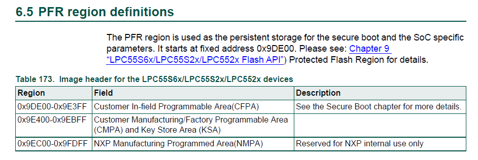

May I know why the protected flash region is allocated at address 0x0009_FC70 onwards on LPC55S69. This is a Non-secure address according to the memory map overview. I wonder how this Non-secure region is protected?

Hello Sherry,
Hope you are doing well.
LPC55Sxx contains configuration for the boot ROM in flash region which is protected. This protected region contains settings of boot configuration, security policy, PRINCE settings and so on.
Could you please confirm where you see that the PRF is from 0x0009_FC70 onwards? Maybe you are referring only to the UUID.
The PFR region is as below:
A mass erase will not erase this protected area, you need to access to it  by using ROM APIs.
