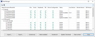

Using the IDE menu ConfigTools -> Data Manager you can get an high-level overview what is supported and what not:

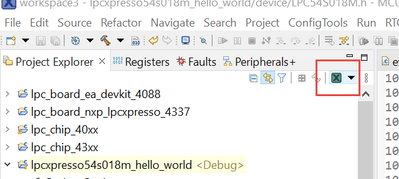

Hello devel,
How about click below button, the .mex file will appear:
Alice
