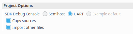

I import the SDK led_blinky sample project and I select "UART" for the SDK Debug Console:

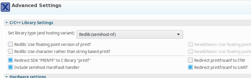

And I select "Redirect printf/scanf to UART":
The default configuration uses UART1 but for various reasons we need to use LPUART0 on our custom board.

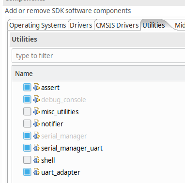

It looks like the debug console is using the serial manager.  I dug around and found that there is a "uart_adapter.c".  There is an option in the SDK Component Manager for uart_adapter but nothing that I could find for an lpuart adapter.

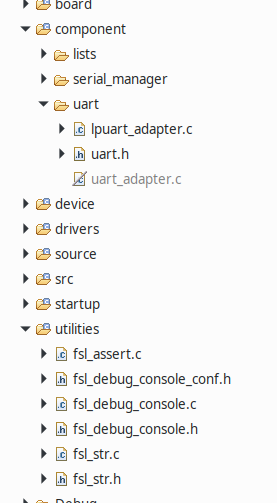

So I googled "lpuart_adapter.c" and found a copy on the internet.  I copied it as shown and excluded uart_adapter.c from the project:
I modified the defines and removed the ones that are not being used:

It seems there isn't such an example. But it's not a hard work. UART and LPUART has almost same function name.
1. change pin config
2. copy lpuart driver to project.
3. modify the define
4. change the function name in fsl_debug_console.c
