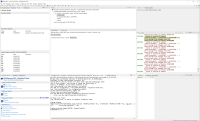

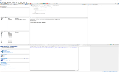

I'm testing the FRDM-K32L2B3 evaluation board using MCUXpresso SDK and IDE as described on the "Getting Started" page but the MCU is unable to run the generated SDK sample code.
I did exactly the following:
  • Open URL https://www.nxp.com/design/development-boards/freedom-development-boards/mcu-boards/nxp-freedom-deve...
  • Click on "GET STARTED"
  • Click on "Jump To => 2. Get Software"
  • Click on "GET MCUXPRESSO SDK" (Download SDK_2_6_0_FRDM-K32L2B.zip)
  • Click on "GET MCUXPRESSO IDE" (Download MCUXpressoIDE_11.4.1_6260.exe)
  • Click on "Jump To => 3. Build Run"
  • Click on "USE MCUXPRESSO IDE" (Open "Running a demo using MCUXpresso IDE" document)
  • Install "MCUXpressoIDE_11.4.1_6260.exe" and open the IDE
  • Drag and Drop the file "SDK_2_6_0_FRDM-K32L2B.zip" into the "Installed SDKs" view
  • Click on "Import examples from SDK" in the "Project Explorer" view (Show the selected "frdmk32l2b" SDK)
  • Click on "Next"
  • Select the example "demo_apps / led_blinky"
  • Click on "Finish"
  • Click on the "frdmk32l2b_led_blinky" project
  • Click on "Build"
  • Click on "Debug"
    Panel "Probes discovered" pop up and show the "CMSIS-DAP" available probe.
  • Click on "OK"
Debug result in this screenshot:
I tried also the "hello_word" code sample with the same result.
Thanks' for your help.
Claude

ClaudeHenry
I didn't find anything that can help me to fix the issue actually.
I did the flash mass erase with the MCUXpresso IDE but this doesn't fix the issue.
I would like to use the "blhost" tool to try to flash the MCU but I didn't find a way to reset the MCU in BOOTROM mode.
Normally I should be able to do that by pressing the button 2 (connected to the NMI) during power up or MCU reset.
Also, is there a way to program the flash FTFA option bits with the MCUXpresso IDE ?
Claude

ClaudeHenry
I already tried to do the mass erase with MCUXpresso IDE but this didn't solve the issue.
Also I can read the flash, so it doesn't seem to be read protected.
Claude
