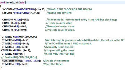

I was worked with  Developed Board of LPC804 Micro-controller. Where i was using the Timer SDK Example to configure the timer and generate the interrupt in the Micro-controller.After I was developed the own timer code.In the code I didn't got the Interrupt in the code.I was attached below my configuration code.Please check and kindly reply us.
void timer0_Init(void)
SYSCON->SYSAHBCLKCTRL0|=1<<25; //ENABLE THE CLOCK FOR THE TIMER0
SYSCON->PRESETCTRL0|=1<<25; //RESET THE TIMER0;
CTIMER0->CTCR|=0X0;
CTIMER0->TC|= 0X0;
CTIMER0->PR|= 0X0;
CTIMER0->PC|= 0X0;
CTIMER0->MR[0]|=1500000;
CTIMER0->MCR|=1<<0; //An Interrupt is generated when MR0 matches the values in the TC
CTIMER0->MCR|=1<<1; //The TC will be reset if MR0 matches it.
CTIMER0->TCR|=1<<1; //Manually Reset Timer0
CTIMER0->TCR&=~(1<<1); //Stop resetting the timer.
CTIMER0->IR|=0XF; //Clear MR0 interrupt flag
CTIMER0->TCR|=1<<1; //Start the Timer
EnableIRQ( CTIMER0_IRQn); //Enable the Interrupt

The reason in which the timer driver have default IRQ handler for Timer0,1,2,3,4. where I was able to use to generate the Interrupt inTimer 0 only.Remaining Handler function unable to generate the Interrupt.
1.First Image and Second Image(This Image have the Timer Initialization function for Timer 0 and which correctly generate the Interrupt in the Handler function).Timer0_Initilization(First Image)Timer0_Initilization(First Image)Timer0_Handler_FunctionTimer0_Handler_Function
Third Images(Third Images Indicates where I was Initialization the both Timer0 and Timer 1 function ).
Fourth Images(Fourth Images Indicates where I was Toggle the pin in both Timer0 and Timer 1 Handler function).
Timer 0 and Timer 1 Initialization FunctionTimer 0 and Timer 1 Initialization FunctionTimer 0 and Timer 1 Handler functionTimer 0 and Timer 1 Handler function
ii)User manual of LPC804 denotes one General purpose Timer function.But in software we having up to 5 Timer Handler function.How many timer Generally used in the LPC804?

The LPC804's core only has one handler for CTIMER0, so you will need to evaluate which channel is triggering the interrupt using the (user manual 16.6.1) Interrupt Register, please take this into occunt while developing your custom driver. I recommend you to use the handler that the example has and inside the interrupt verify which flag is triggered on the register.
