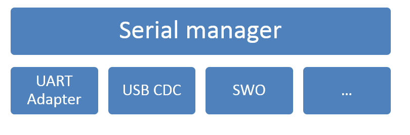

danielchen
The purpose of the serial manger is to mask the differences in multiple hardware modules.
The architecture of the serial manger is shown below:
For your case, serial_manage.c is in a high level.
