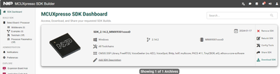

maybe a triviality but I could not solve it by looking into docu. I try to look into a i.MX93 possibility.
  • Installed MCUXpresso IDE v11.9.0
  • Then I went to NXP to the mcuxpresso MCU dashboard and created for a i.MX93 a SDK, named SDK_2_14_2_MIMX9301xxxxD.zip
  • Now I started MCUXpresso. It want me to drag that zip into the "installed SDK" view
  • When I do this  get errors like:
  •     -The SDK 'SDK_2.x_MIMX9301xxxxD' does not contain any MCUXpresso IDE compatible toolchain
  •      -Recreating part support. No part support available.
Did I do sth. obviously wrong?

Toolchain was set up as "all toolchains"
1,439件の閲覧回数
Zhiming_Liu
How did you choose toolchain when you download SDK?
1,344件の閲覧回数
Vitus
I heard now indirectly, that the MCUXpresso does not support i.MX93, If someone from NXP could confirm, that would be nice
