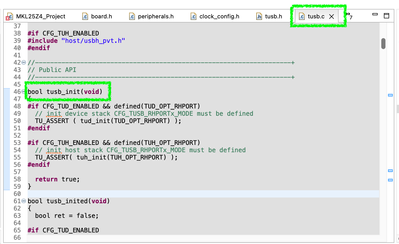

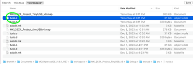

The compiler is creating the tusb.o object file:

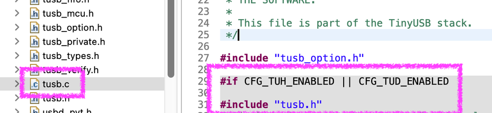

And that object file comes from tusb.h and tusb.c (where tusb_init() is defined):

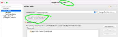

I saw your post about exclusion earlier and made sure that the exclusion check box was not checked.
and I looked at the alternative that you suggested and it seems to be on the default (assuming that means include in build)

the linker error is about the fact that it does not find the function tusb_init(). Check your sources and find out where this function is located, and if the module for it (.o) is listed in the ones passed to the linker.
It could be that you have missed including/compiling that file or folder for it. Make sure the file or folder is not 'excluded from build', see https://mcuoneclipse.com/2014/07/22/exclude-source-files-from-build-in-eclipse/

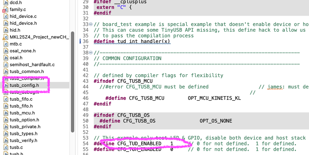

Aha. I believe that I've figured it out. It had nothing to do with MCUXpresso's settings. They were fine. What was going on is that the TinyUSB library uses preprocessor defines in a configuration file that are then interpreted to include (or not) the header file.
Once I defined it properly, the linker was able to find the resulting object file.
