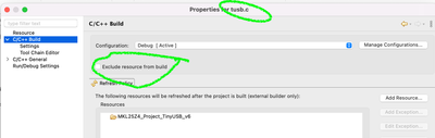

drsmith_yorku
Vielen Dank, Erich!
The compiler is creating the tusb.o object file:
And that object file comes from tusb.h and tusb.c (where tusb_init() is defined):
I saw your post about exclusion earlier and made sure that the exclusion check box was not checked.
and I looked at the alternative that you suggested and it seems to be on the default (assuming that means include in build)
all the best,
James

ErichStyger
Specialist I
Hi James,
what about the folder properties where the file is in?
Maybe the folder is not included into the build?
Erich

drsmith_yorku
Aha. I believe that I've figured it out. It had nothing to do with MCUXpresso's settings. They were fine. What was going on is that the TinyUSB library uses preprocessor defines in a configuration file that are then interpreted to include (or not) the header file.
Once I defined it properly, the linker was able to find the resulting object file.
