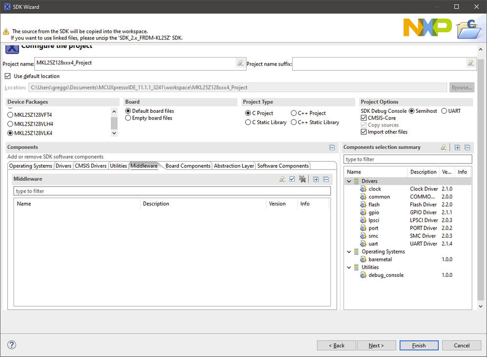

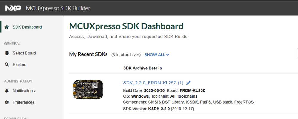

Configured SDK as shown below.
Installed SDK. Go to create New Project. Middleware tab is blank?

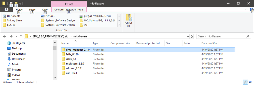

Windows browsed to downloaded .zip file. Contents shows Middleware folders and data. Why is this not showing up in Mcuxpresso?

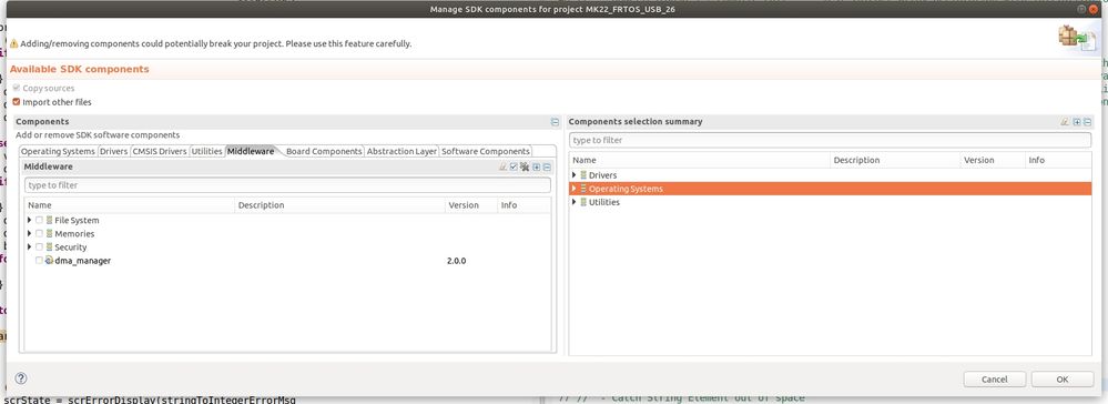

I have a similar but possibly different issue.  I am trying to add USB Host middleware to an MCUXpresso project in the IDE (v11.2) using the "Manage SDK Components" dialog (for a FRDM-K28F board).  The Middleware section will not appear in the peripheral tool and there is no way to configure Host Roles, Use Case presets etc.

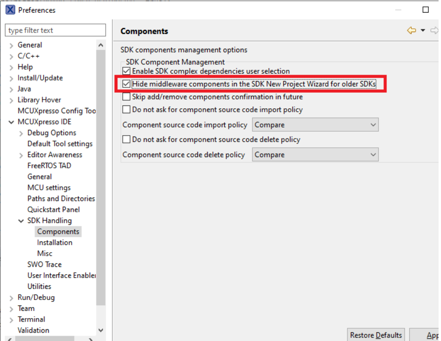

danielchen
Hi Phil:
The visibility of "middleware " components in MCUX IDE, for SDKs with SDKs with manifest version older than 3.2.0 is controlled by a checkbox in preferences.

I just tried it with the latest version of the MCUXpresso IDE and the MK22FN1MA0xxx12 SDK (2.3.1) - when you disable the hidden middleware components, something does come up there now....
But, it doesn't list the USB components (which both philmcmillan‌ and I are looking for).
So I guess my previous comment still stands - if you want USB for these devices you have to copy in the components from example projects.
myke
1,810 Views
danielchen
Yes, your previous comment still stands. For SDK packages from earlier SDK releases, the manifest file does not contain information for proper appearance of middleware components.
