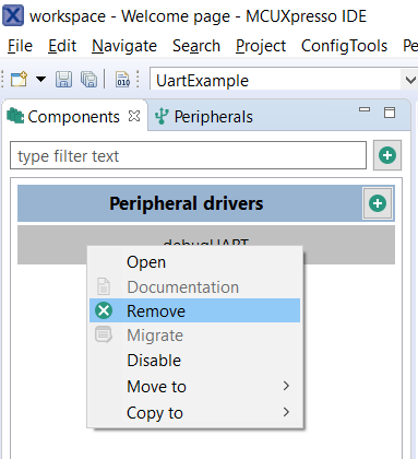

To remove component, you can right-click on it in the Components tab and select Remove:

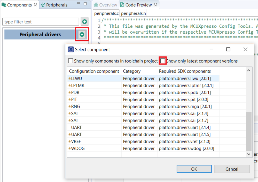

To add a new one, click on the "+" button next to "Peripheral drivers" title. In the Component selector window, make sure that the "Show only latest component versions":

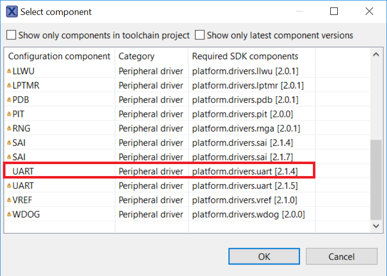

the compilation error is caused by combination of incompatible version of Peripherals tool component and SDK driver. Your project is based on MCUXpresso SDK v2.2 which contains UART driver v2.1.4, however, in Peripherals tool you are using UART component for SDK driver v2.1.5 which has different API from v2.1.4 (the uart_config_t differs). Please remove the Peripherals tool component v2.1.5 and replace it with v2.1.4 using component selector:

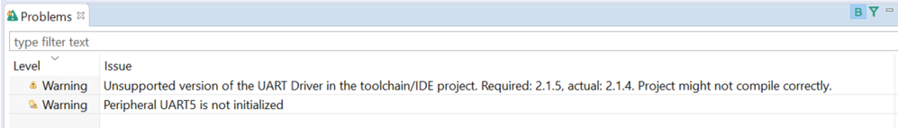

There should be also visible warning about the incompatible versions in the MCUXpresso Config Tools Problems view:

Can you provide a link on directions to remove and replace the toll component.  The one link I did find https://community.nxp.com/thread/506760
I attempted to perform the "right button" of the warning, but could not get the indicated window to appear.
3,697件の閲覧回数
Lukas_Heczko
The Peripherals tool components are downloaded automatically.
