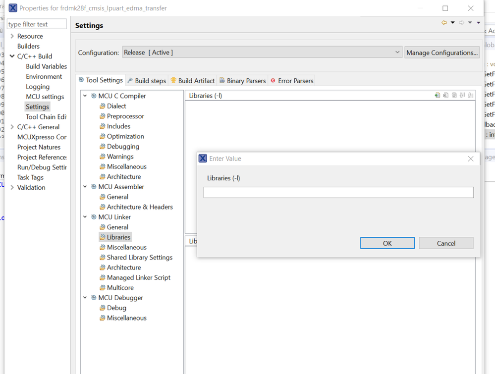

Can we integrate any explicit library like openthread  into MCUXpresso IDE?
If so, please let me know the procedure. Thanks!

jingpan
of course you can. Please add here

BlackNight
In addition to the information from Jing:
If your library is named 'libMyLibrary.a', then omit the prefix and extension for the -l option, e.g. use -lMyLibrary
