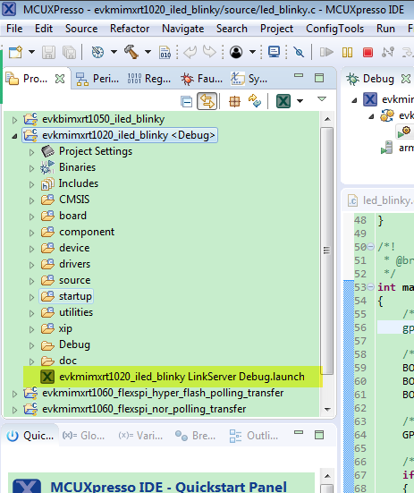

    3. you can delete the .launch on the MCUXpresso IDE project

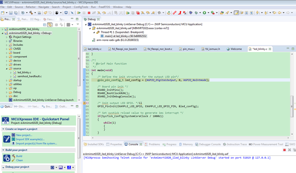

  5. Please build the project, and download it again. You can test the iled_blinky project.
    This is my test result:
Please try it again.
If you still have problem, you can set SW8_4 ON,then all SW8_1,SW8_2,SW8_3 OFF.
Then download the code, disconnect the debugger, change the SW8 back to SW8_3 ON,then all SW8_1,SW8_2,SW8_4 OFF.again, now try again.
