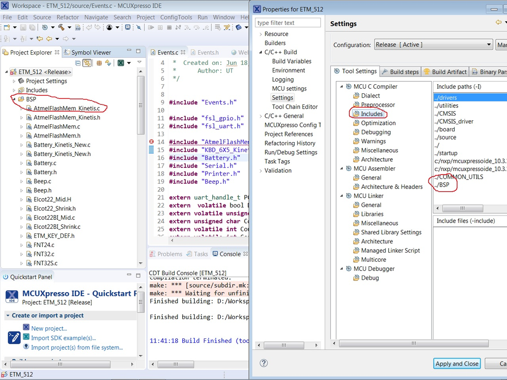

When I try to compile my project in MCUxpresso I get this message, even my file is present.
I have added two virtual folders and have included linked source files from another folder using drag drop method.
One folder is "source/BSP" and another is "source/COMMON_UTILS".
When a header file from BSP is included in some header in COMMON_UTILS it shows this error message. The headers are getting compiled when any file in the "source" folder includes it.
I am attaching screen shot of settings.

Hi Uday,
Please check that you have the folder included in Properties > C/C++ General > Paths and Symbols > Includes.

It is already done. Still the problem is same.

converse
Senior Contributor V
Not certain about this, but it looks like your directory is called ‘source/BSP’. I.e. it is not a sub directory, but has a/ in the name..,

thanks for the observation. Actually it was a wrong screen shot from my end. I was trying many things to go ahead. Now I have posted correct case.

Not sure if I understand the issue. But: you have to provide for the compiler the path where that header file is located (usually with the -I compiler option in the project settings).

Yes that time the source folder was created in the source as sub folder. Then I have tried creating BSP folder in the root of the project and sending screen shot which explains it all.
I observed that when I copy the file in the folder then it does not give error but when a link to file is added it gives error.
This screen shot makes it more clear
