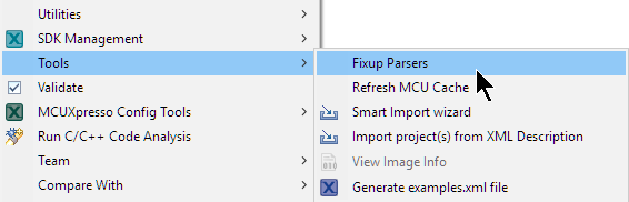

this is what helped for my projects:
1) right-click on the project and use Tools > Fixup Parsers

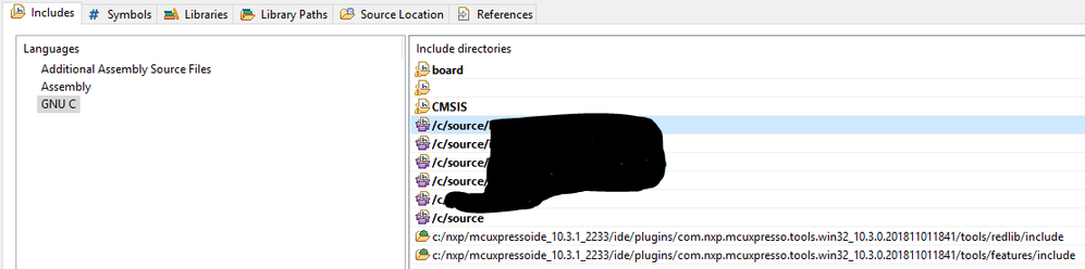

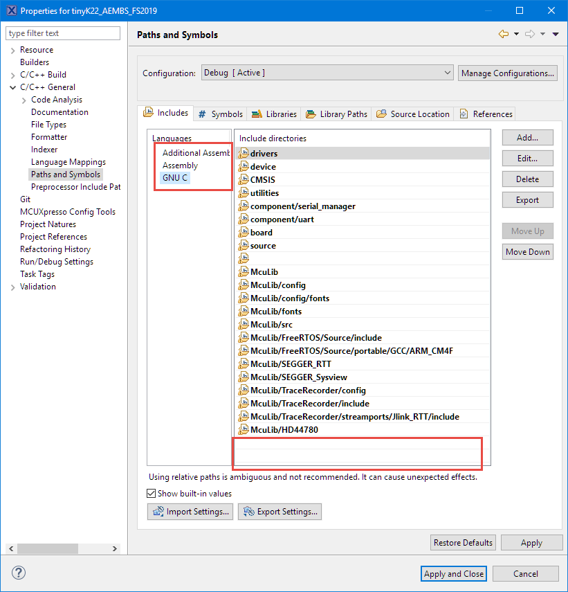

2) checking the Paths and Symbols for the project and removing any references to the IDE or previous IDE installation:

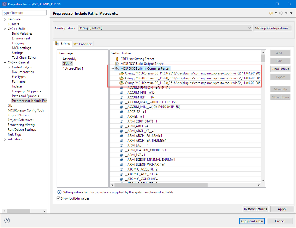

3) Checking that there is an 'MCU GCC Built-In Compiler parser' present pointing to the Include folders in the IDE:

luke_ludington
The MCU GCC Built-In Compiler parser doesn't show up how do I add it?
7,191 次查看
BlackNight
it should get added with the menu Tools > Fixup Parsers
can you retry?

luke_ludington
I can't seem to delete these references to the IDE, I tried your given process a few times. Thanks for all of your quick responses so far.
7,191 次查看
BlackNight
Strange.
This is what I had: I selected the item pointing to 10.3.1 and used the 'Delete' button.
This is not possible for you (you did not share the state of the button)? Or what do you get (error message?).
Erich
7,191 次查看
luke_ludington
Yeah the delete button is greyed out and the delete key does nothing
