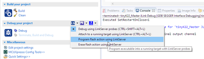

Inside the MCUXpresso IDE, I hope you have noticed the 'flash' button so you don't need to 'debug' it:
