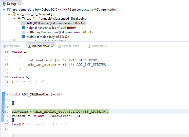

Hi Joschka,
Actually I didn't find any obvious error from your code, I just tested your code based on the project of "app_demo_dp_blinky", and almost all of the codes are from yours , the change I made is adding Board_Init() in the beginning of main().
The application runs just as expected.See the breakpoint hit as shown below.
did you test the same? or did you use the demo board or custom board? Please kindly clarify.
Kan
