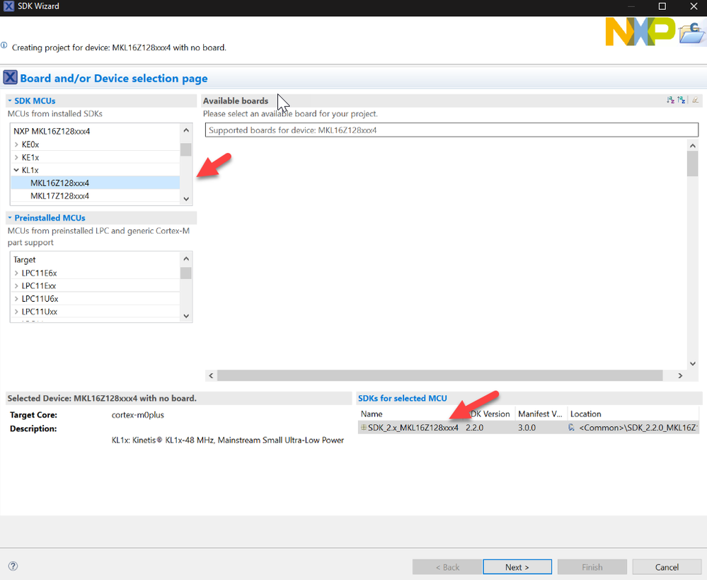

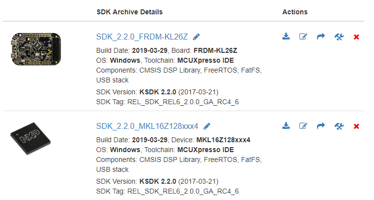

I'm using the SDK from FRDM - KL26Z and MKL16Z128xxx4. Both SDK_2.2.0 Version,
I create a new project for the KL16Z:
And import the libraries I need for the demo I want.

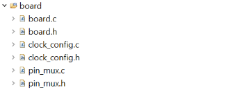

Using the example from the SDK FRDM_KL26 adc16_interrupt as an example, set the new project for the KL16Z. The files you would need to change are this, check the files from the KL26Z to base the new project.
The option Robin mention is also valid, the diferences between this MCU is only the inclusion of the USB, the linker and the start up  code is almost the same with the inclusion of the USB interruption.
