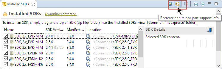

I do have as well 2.4.x SDK versions, but on my end the following helped:
Can you try this (if not already)?
I hope this helps,
Erich

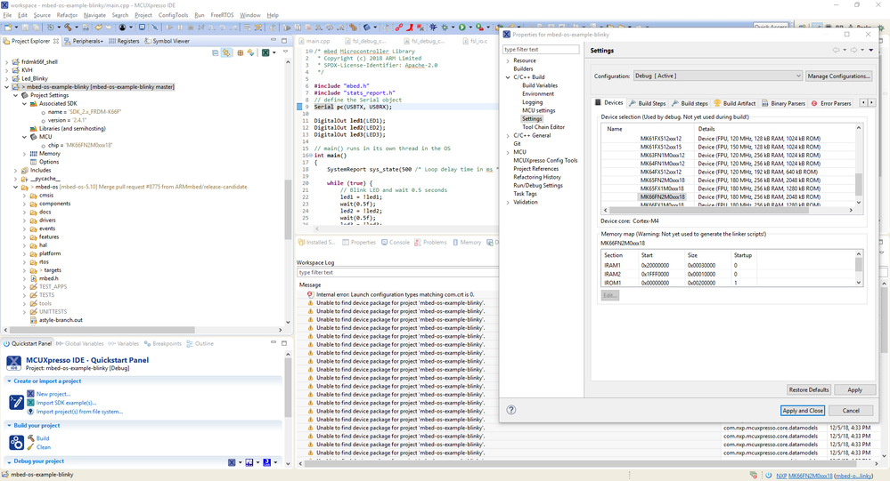

I get the same error.  If I click on any tab other than "errors", I get brought back to the errors tab with about five new entries about not having the device package for the project.  I have the SDK installed as you can see in my project explorer.  I've selected the MCU under the MCU page of the project settings and also under the devices tab of the c/c++ settings.  I believe the latter is the one the actually starts it off throwing the error.  Also, MCUXpresso config tools, despite all these setups, still starts off with the wrong board selected.

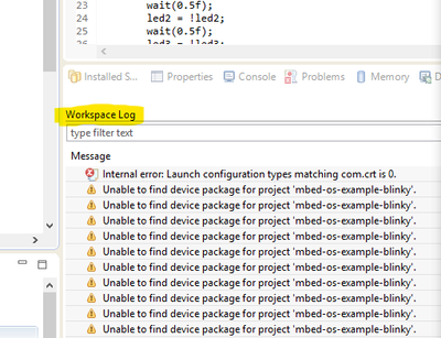

Just came across this 5 year old posting that shows a "Workspace Log":
I wondered how you open this "Workspace Log".
The answer is: you have to open the aptly named "Error Log" in Window > Show View > Other dialog.
Hope that helps anybody who has the same question.
