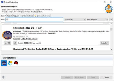

Probably the easiest route is installing the Eclipse Embedded C/C++ plugins from the Marketplace:
By default this uses the standard/external GNU ARM Toolchain, see https://mcuoneclipse.com/2017/07/30/breathing-with-oxygen-diy-arm-cortex-m-cc-ide-and-toolchain-with...
I hope this helps,
Erich
