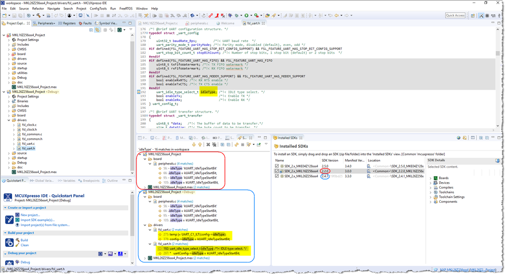

In the IDE I used the Config Tool to generate my peripherals.c and peripherals.h files.
When the project is compiled, the structures UART_1_config, UART_2_config, and LPSCI_1_config have compile errors:
../board/peripherals.c:66:4: error: 'uart_config_t {aka const struct _uart_config}' has no member named 'idleType'
../board/peripherals.c:144:4: error: 'lpsci_config_t {aka const struct _lpsci_config}' has no member named 'idleLineType'
I am guessing that the Config Tool is generating code for a version of the SDK that does not match my installed SDK.
How do I sort this out?

Robin_Shen
Sorry for my late reply!
It was caused by the version of SDK_2.x_MKL16Z256xxx4 is too old.
The newer SDK of KL26 will not get this error.
Robin

bgraham
I switched the project from the MKL16Z to the MKL26Z (MKL16Z is the actual
MCU), and replacing the SDK 2.2.0 with SDK 2.4.1.
This required a lot of changes to the project, but it builds without errors
or warnings.
Thanks for the suggestion.
Bruce
