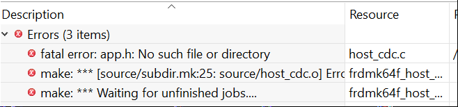

If I understood your correctly, if I add a .c source file in a subdirectory under /source, e.g. /source/App/mainprog.c, I don't need to add the ../source/App  to the above INCLUDE list?   But if I add the header file in a subdirectory, e.g. /source/App/mainprog.h, I have to add ../source/App to the INCLUDE list?
Or whether I add a .c or a .h in a new subdirectory e.g. /source/App, I should put that on the INCLUDE list?
Else, compiler will not automatically create make file & build the new file folders?
Thanks again for the help.
MI
3,497 Views
FelipeGarcia
Once you build the project, MCUXpresso will give you an error that the project cannot find the file. Please check snippets below.
Once you add the new directory to the includes paths you shouldn’t have any issue.

FelipeGarcia
Hi MI,
You shouldn’t have any issues creating a new folder under the source folder.
If you add a header file to the source directory, you may have to add it in the include paths in Properties > C/C++ Build > Settings > Tool Settings > MCU C Compiler > Includes.
I hope it helps!
