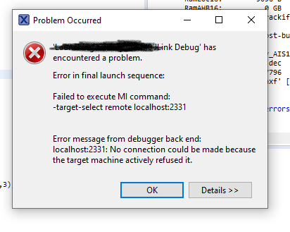

I'm doing some development with a FRDM-K66F board and MCUX v11.0.0.  On Friday, I had the "lwip_tcpecho_freertos" demo running on it just fine using the onboard J-Link OpenSDA.  Then I upgraded my machine to Windows 10 v1903 (from v1803).  I fear this might have been a mistake.
I've restarted my machine, power-cycled the FRDM kit (disconnect/reconnect USB), deleted the old launch file, started MCUX 11.0.0, shift-clicked the blue bug to discover the J-Link OpenSDA probe (again), and launched the debug session.  After a few seconds, instead of the J-Link four-bar-graph window popping up, I get an MCUX error dialog:
Error in final launch sequence:
Failed to execute MI command:
-target-select remote localhost:2331
Error message from debugger back end:
localhost:2331: No connection could be made because the target machine actively refused it.
localhost:2331: No connection could be made because the target machine actively refused it.‍‍‍‍‍‍‍‍‍‍‍‍‍
Needless to say, this makes the IDE pretty useless for downloading new builds to target hardware.  Is there some Windows Firewall settings that I need to change?  Please help... this was working before my Windows 10 v1903 upgrade, and I fear that others may encounter the same issue.  Thanks.

Please check the Windows device manager, the FRDM-K66F OpenSDA J-Link debugger tool was recognized.
If no, please re-install Segger J-Link software package and related driver.
If yes, please select the correct port, should be USB in debugger config panel for Segger J-Link.

Hi, I have experienced the same issue, asked by drodgers‌. There's no issue in the device as seen from device manager. And also I've updated the driver from segger website to 6.80 which is found to be the latest.
I have worked on MCUXpresso with no issues like this for more than a year, This is the first time am facing such an issue. Kindly help me with a solution.

Could not select J-Link with specified S/N (788594195).
GDBServer will be closed...
Shutting down...
Could not connect to J-Link.
Please check power, connection and settings.

The J-Link driver was already being recognized, but apparently installing the latest (v6.46j) SEGGER drivers made things happy again.  Not sure why that was necessary, but at least it works now.  Thanks.

To find which driver? The error indicates that either your target is not powered (or most likely) you got the SWD cable oriente the wrong way: make sure the red wire corresponds to pin 1.
