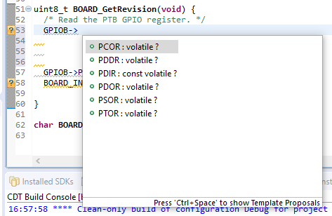

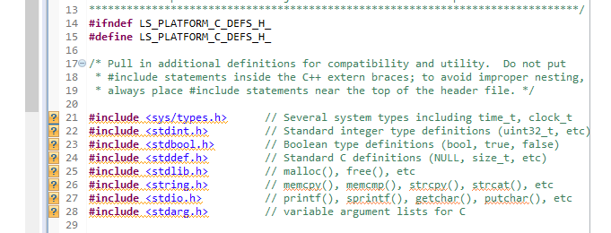

Odd thing that's happened that I haven't encountered before... I'm developing a new C project for a Kinetis K24, the project compiles, links, and debugs fine.  But the IDE has apparently lost track of where the standard header files are.  Example from one of my main header files:
This then leads to all sorts of annoyance, especially when viewing code suggestions:
Why can the IDE suddenly no longer find the standard header files?  Is there a simple way to investigate and fix this?  Thanks.

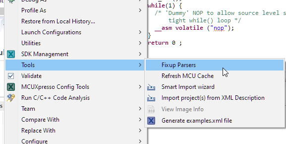

BlackNight
To follow up on this thread:
The IDE V11.0.0  (and later) have a context menu item (right click on the project main folder) which fixes the parser for any projects which expose this issue:
Tools > Fixup Parsers
I hope this helps,
Erich

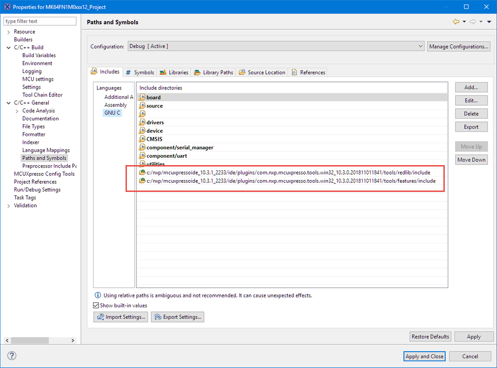

BlackNight
Hi David,
There has been a similar report here: MCUXpresso - how to set the default/system include paths
This has been investigated by the IDE team and a fix for this will be available in the next update (probably a few weeks out).
Normally you should see the necessary include paths here:
If not present, you can add the following paths (depending on your toolchain) to the compiler include paths:
  • C:\nxp\MCUXpressoIDE_10.3.1_2233\ide\plugins\com.nxp.mcuxpresso.tools.win32_10.3.0.201811011841\tools\redlib\include
  • C:\nxp\MCUXpressoIDE_10.3.1_2233\ide\plugins\com.nxp.mcuxpresso.tools.win32_10.3.0.201811011841\tools\features\include
I hope this helps,
Erich
3,154 Views
dmarks_ls
Senior Contributor I
Well, you were almost onto something there.  You're right, those built-in paths were not showing up in my current (but still fairly new) project.  They ARE there in a brand spanking new project that I just created.  So I tried adding them to my existing project, and that caused my build to fail, because now some Redlib type definitions were conflicting with Newlib, mainly because (I think) Redlib defines int32's as int, while Newlib defines them as long.  (To be clear, my current project is Newlib because I need the malloc() thread safety hooks that NewlibNano was not compiled with, and because Redlib is not C++ compatible, so this C project uses Newlib to maintain compatibility with our libraries.)  So I swapped "arm-none-eabi" for "redlib" in the path above, and now it's back to building OK.  So clearly, even though it's not displayed as a built-in, the IDE is still using the Newlib include path to build the project.  And to be clear, I haven't been having any build failures, only indexer issues.
Unfortunately, this hasn't fixed the indexer issue.  I tried "Index / Rebuild" and "Index / Re-resolve unresolved includes" at multiple points, but the indexer remains ignorant of where those header files are, and keeps showing the orange squiggles.  So, no resolution there.  I don't know where the indexer draws its configuration from precisely, or if there's some way to inspect that.

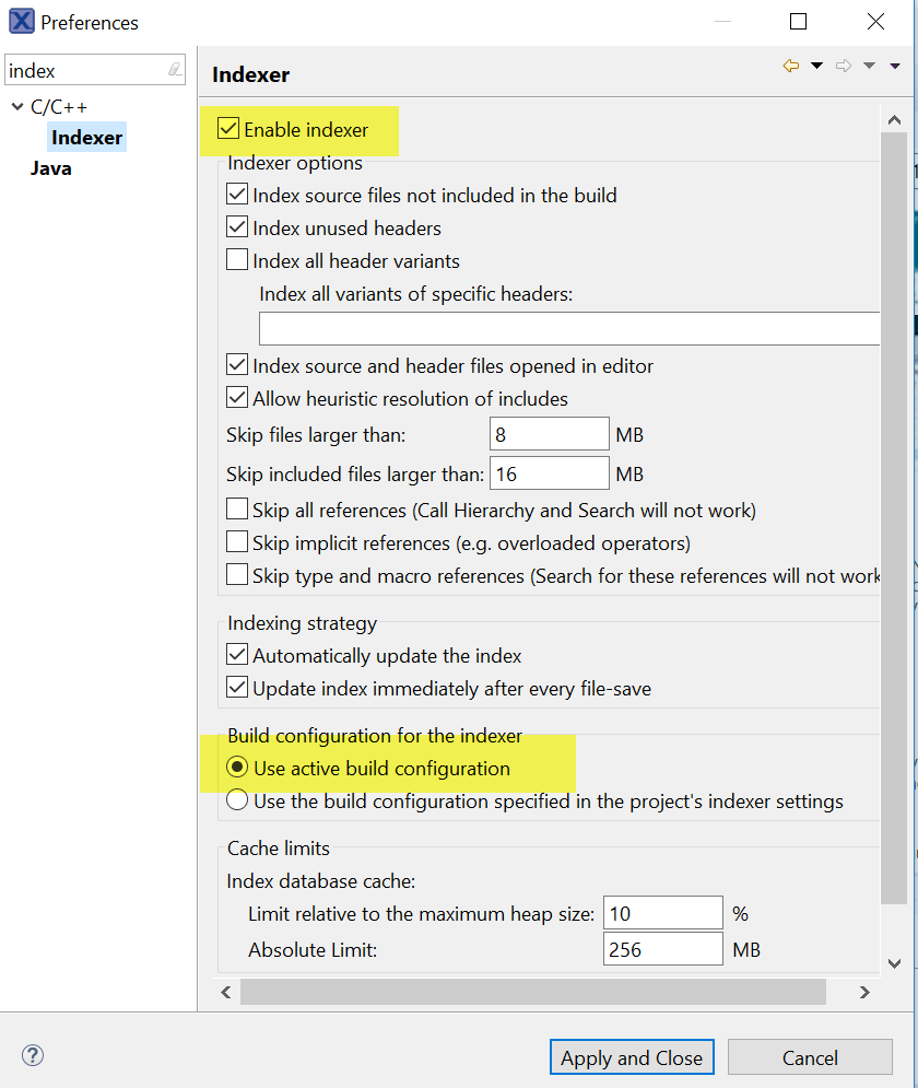

ZhangJennie
Hi David Rodgers
Please check if you check enable indexer option. if still can't fix the issue, please create a new workspace and test your project in this new workspace.
Jun Zhang
3,154 Views
dmarks_ls
Tried what you suggested, didn't work.  I already had "Enable indexer" checked, made sure that "use active build configuration" was selected.  So I created a new workspace from scratch, reloaded my code template and code formatter settings, pulled a fresh copy of my project from SVN, imported it into the workspace, and checked one of my header files... still shows orange question marks for all system include files.
