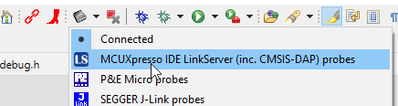

We are working with i.MxRT1021 chipset.  MCUExpresso version 11.7.1.  Process to connect was to right-click on the Project and select "Debug As"->"2 MCUXpresso IDE link Server... probes"
Or directly using the Flash Utility off the Toolbar:

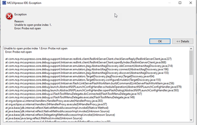

Either way, we select the MCULink serial #, and it churns a bit and both ways fails with this window:
Interestingly, we discovered that MCUExpresso 11.6.0 is also on this same PC-- and it works, but this older version of the IDE is only compatible with older RT1021 EVK (rev A) and older MCULinks running  pre 3.x  firmware.  That implied to us a problem with something in MCUExpresso 11.7.1.
This occurred around the same time a redlink server script was accidentally executed from a command window while an active debug session was running in MCUExpresso 11.7.1.  Our suspicion is some sempahore/mutex lock is stuck, but we're unable to figure out where 11.7.1 stores that information.
