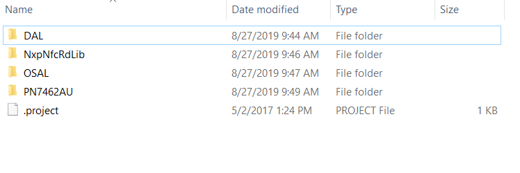

I believe the information that will be quite helpful for you will be the available documentation in the Reader Library Package.
Once you have the reader library for you device, you will need to enter to the following path
<installation path>\PN7462AU Software\PN7462AU-FW_v05.22.01_Full\PN7462AU-FW_v05.22.01_Full\ApiDocumentation
There you will find the following folder structure:
In each folder you will fin a .html  , if you open it you will find a description of all the APIs in the library.
Another option you have to understand in a better way the library, it's to check the available webinar we have that explains the architecture, the examples, documentation etc.
You can find it in this link
Hope it helps
