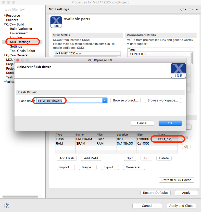

lpcxpresso_supp
Hi Ricardo,
Thank you for your report. Upon investigation I can see that the SDK for this part specifies a flash driver called FTFA_1K.cfx. This flashdriver uses RAM beyond the range supported on this device.
The appropriate flashdriver for this part should be FTFA_1K_Tiny.cfx - fortunately, this driver is supplied with the IDE and can be selected for your project...
To do this, right click on your project and select 'Properties'. From the dialogue (shown below), select MCUSettings and click the '...' in the Driver Column. From the LinkServer flash driver dialogue, select the FTFA_1K_Tiny.cfx flash driver and click OK -> Apply and Close.  This will associate the new driver with your project.
Further, I will look to correcting the SDK for this part.
Yours,
MCUXpresso IDE Support
