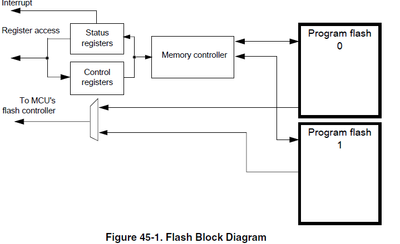

From "K32 L2B Sub-Family Reference Manual",
What does it mean for the above table?
My application,
Such as: application SW is about 100k, the flash is 128k, flash 0 and flash 1 is equal(64k). Now I want to use the last page of flash 1 as eeprom emulator. Does this design work?
BTW,
What does it mean?
Can the flash be programmed and read for 8 bits, 16 bits and 32 bits? All these bits are supported?

Hi @rodger_an
I would like to apologize for the delay. We are experiencing high volume of questions these days. I really appreciate your patience.
Regarding your question, that table means that you can do two operations at the same time to the 2 different flash memories that mcu has, for example you can read Flash 1 while you are programming Flash 0.
In order to use a flash as EEPROM, which design you are referring to? I can suggest you to read this thread of our community to use flash emulating an EEPROM: https://community.nxp.com/t5/Kinetis-Microcontrollers/Ways-of-Storing-data-in-non-volatile-memory/td...
And for your last question, you can only read from flash 8-bit, 16-bit or 32-bit too, but not program those words size,
Hope the information is helpful, please let me know if you have more questions.

Thanks for your feedback.
Now I know kinetis flash can not read and programmed/erased a same flash bank at the same time.
If I want to do this, it have to copy run command to ram or enable ESFC bit in MCM PLACR.
But I found the SDK as below. when FTFx_DRIVER_IS_FLASH_RESIDENT is open, it will copy run command to ram. but why do not add disable interrupt and enable interrupt before and after  running flash ram command. Also do not Enable stalling flash controller when flash is busy when FTFx_DRIVER_IS_FLASH_RESIDENT is not open.
if do not do this, it will lead something wrong, such as: chip reset(flash operation hard fault), print out messy logs, when read and programmed/erased a same flash bank at the same time.
