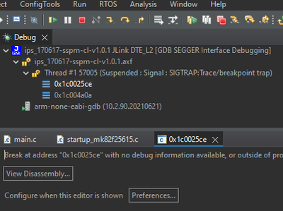

I need some troubleshooting ideas.
I have a custom board with K82, SDK2.8.0, MCUXresso IDE v11.7.1_9221, Segger J-Link Compact. There's a debug console on LPUART4.

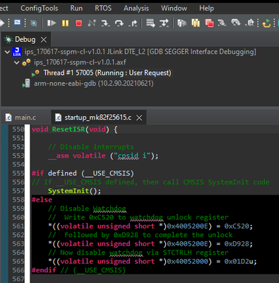

Execution fails before hitting initial breakpoint. Debugger opens view on startup_mk82f25615.c:
If I hit pause:
If I then disconnect J-Link and power cycle the board it still does not run (my LED heartbeat indicator is dead).

This was caused by the Flash Option (FOPT) Register config in startup_mk82f25615.c.
The board has a PN5180 NFC Frontend that uses the NMI pin on PTA4 for its IRQ.  This pin is also used for the K8x boot, but should not be.  The startup_MK82F25615c template used by the SDK sets the FOPT Config to 0x3D, which has
  • NMI_DIS bit is set, (NMI pin/interrupts reset default to 'enabled')
  • BOOTPIN_OPT is not set (which forces Boot from ROM is BOOTCFG0 is asserted - requires RESET pin enabled)
Changing to 0x3B:
  • NMI is not set (NMI Interrupts are always blocked)
  • BOOTPIN_OPT is set (requires BOOTSRC_SEL to be set)
  • BOOTSRC_SEL is 00b (Boot from Internal Flash)
Which Stabilizes the debug environment so that it behaves as expected.
