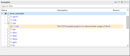

Hello, where I can find example projects per specific functionality? In my case I need a tutorial how to use and implement watchdog functionality for K32L2B21 processor, but I can't find such examples in NXP SDK. Are there example resources somewhere that I can use, or the reference manual is the only available official source? Thank you in advance

You can find a watchdog example at the SDK under the name of COP.
Let me know if this is helpful, if you have more questions do not hesitate to ask me.
