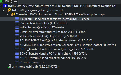

Yes, USB is working with uTasker, but not with SDK examples. I tested with uTasker just to verify that my FRDM-K28F hardware is working properly.  I would prefer to use the SDK examples as a starting point for my development task.
I have tried usb_device_msc_ramdisk (bm + freertos) which have the 'USB device descriptor failed' mentioned above , usb_device_msc_sdcard (freertos)  crashed with  hardfault :

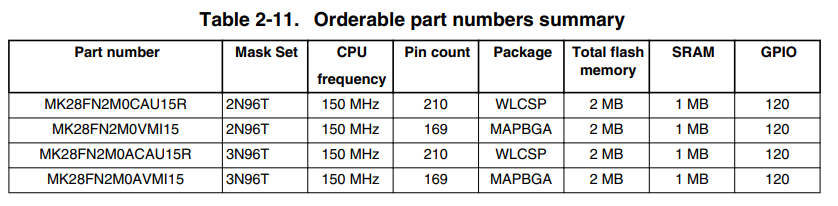

Thanks for the additional information! In the screenshot that you shared, I saw that you are using the SDK for the FRDM-K28FA. Could you please confirm that your FRDM actually has the revision A of the silicon? The following image shows the mask for the different versions of this chip.
Victor

My FRDM-K28F is a couple of years old and have the MK28FN2M0VMI15, whereas the real board we are developing is using MK27FN2M0AVMI15. My intention is to have the USB/MSC working on the FRDM board first, as we have not tested the USB hardware on our real board yet.
Eldar
4,153 Views
eldarfiring
So yes, the SDK I'v built is the 'A' version whereas the FRDM hardware is not. I thought they were binary compatible ?

Hi Victor,
Thank you for pointing that out for me, the problem was the SDK version I used. It is now working for both FRDM-K28F (MK28FN2M0VMI15) as well as my target board (MK27FN2M0AVMI15).
