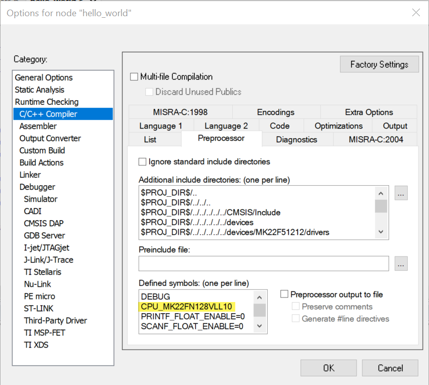

I have a question
I am working with IAR, it generates an error, where I can define my microcontroller MK22FN128VLL10 and how to do it, I thank you very much
1 返信
4,015件の閲覧回数
FelipeGarcia
Hi Oswaldo,
Sorry for the late reply.
You define this macro in the preprocessor defined symbols in project Options > C/C++ Compiler > Preprocessor
Please check the following image:
I hope it helps!
