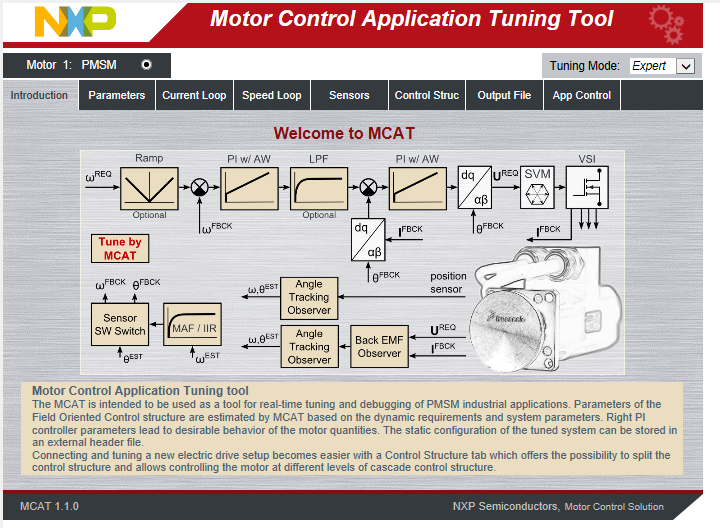

 I am using  am using 3-phase PMSM Development Kit with NXP MPC5604P MCU (MTRCKTSPS5604P).The MCAT tool along with it is of version MCAT1.1.0. But as i go through the documents available regarding the tool, it seems that the tool has revised with more control tab options. Is there apossible method to download the newer version of MCAt tool ? Is it possible to integrate this newer version with the MPC5604P MCU?

Could you please send me a screen, which control tabs are in documentation and you cannot see it in your application?
From the information I received from MCAT development team, version 1.1.0 is the newest one.

fixed-term_apar
yeah sure. above is the screen of MCAT tool in my application
This is the screenshot of control tabs specified in the https://www.nxp.com/docs/en/application-note/AN4642.pdf
as you could see the tool bar has more options in the document.

fixed-term_apar
yes i have found it. Thank you.

I consulted your question with motor control team and I received following answer:
In top right corner, there is a gear symbol, which can be clicked. After the click, you can add motor, and you can add for example also sensorless tab etc.
Please let me know, if you found this option.
