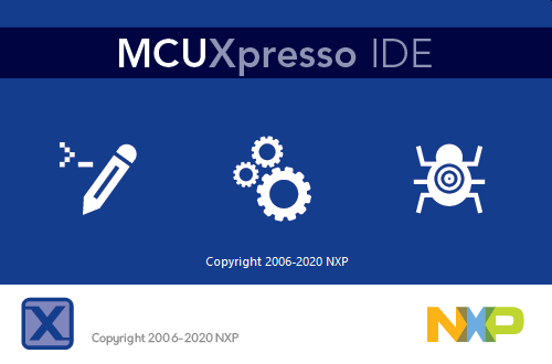

I just installed the new MCUXpresso IDE v11.1.1
I was surprised, that it takes a long time (42 seconds) for the IDE to be ready.
- for the first 20 seconds, there is this splash screen and nothing else happens:

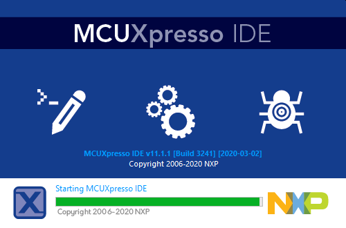

- the next 20 seconds, there is starting action going on with this splash screen. Green progress bar is moving.

As you can see, I startet the workspace at 08:58:00. The next entry is on 08:58:29. This is exactly the duration time of the first "static" splash screen (29 seconds), with nothing else happening. After these 29 seconds, the "second" spash with the "green progress bar" appeared...

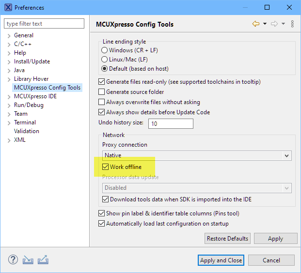

@Erich
Unfortunately, the "work offline" checkbox didn't help.

It takes 11 seconds on my 4 year old and slow laptop.
it certainly takes more time after a fresh installation because it scans the installed SDKs (but this is mostly in the background). So not sure what is delaying it in your case.
Maybe it downloads data from a slow internet connection. What you could try is to switch the config tools into offline mode to check if this helps:
