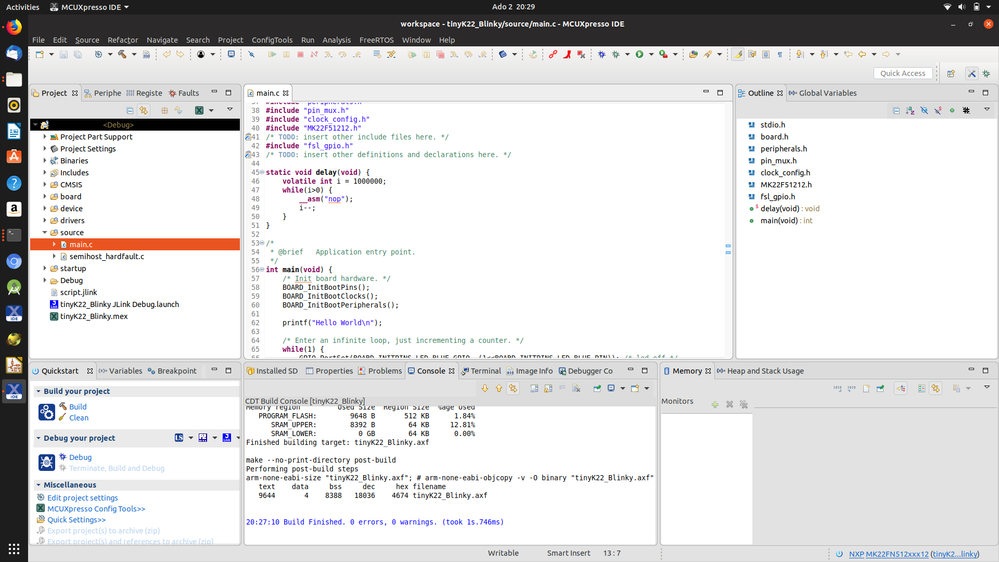

I found solution and got it running  without problems in Ubuntu 19.04Screenshot from 2019-07-02 20-29-13.png
steps I followed (installed the dependencies)
sudo apt install libusb-1.0-0-dev
sudo apt install dfu-util
download  amd64 build of icu 60.1-1
install the package (open terminal from the file location)
sudo dpkg -i libicu60_60.1-1ubuntu2_amd64.deb
download libjavascriptcoregtk-1.0-0_2.4.11-4
and install
sudo dpkg -i libjavascriptcoregtk-1.0-0_2.4.11-4_amd64.deb
download libwebkitgtk-1.0-0_2.4.11-4
and install
sudo dpkg -i  libwebkitgtk-1.0-0_2.4.11-4_amd64.deb
after this you should home and dry  :smileycool:
install IDE
open terminal from file location
install.....
sudo chmod  +x ./mcuxpressoide-11.0.0_2516.x86_64.deb.bin
sudo ./mcuxpressoide-11.0.0_2516.x86_64.deb.bin
