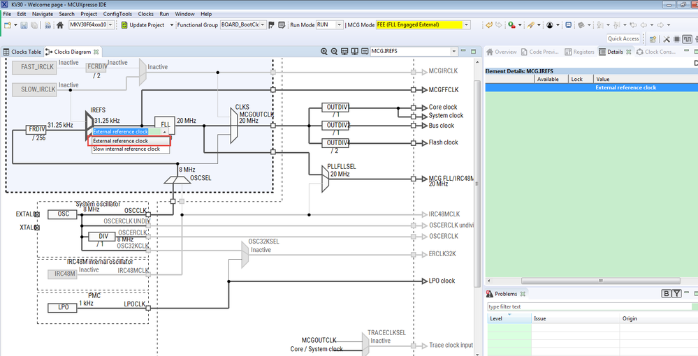

I use MKV30F64VLF10. External 8MHz OSC input. How can I set FRDIV output to active?

Hi Customer,
    Please click the IREFS, select "External reference clock", then the FRDIV will be active:
Wish it helps you!
