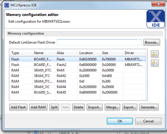

We are currently designing a bootloader that is linking in at the default base of our external Flash (0x6000000).  We need to have a separate exec linked in at a higher address in external Flash.  How do we specify a different starting address (e.g. 0x60080000) for the linker in MCU Expresso?

In general the starting address for different mem space can be edited using the following:
Select the project you are working with, right click then choose Properties ->C/C++Build -> MCU Settings
You can change the location address here, click apply and the changes will be applied to your linker files.

We're using the RT1021 for this project.  If we link the exec at a higher address, can we still use the debugger?

Do you mean if you change the address for the board_flash for example to a higher address like 0x7000000 and still be able to flash and debug your application?

Yes, exactly.  The debugger doesn't seem to work this way.

Thank you for your reply, but I actually got it to work today afterall.   I spoke to a more experienced engineer here and he told me how to do it.  Under project properties, MCU Linker, Managed Linker Script - uncheck "Manage Linker Script" for the target you want to change.  Then modify the linker script that was previously auto generated and change the memory areas designated for each section to the memory area you want to be different.  There you have it.  I have MCUXpresso manage the linker script for debug and I manage it for release.  Works nicely.
