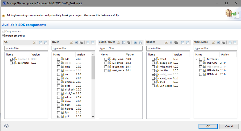

randylee
Contributor V
So a related question to this: How do you create a CDC bare bones project in 10.3 with SDK 2.5?  I'm missing something or other big time here.
My steps: Create no board version of K22FN512 project.  Add the following:
you get a project that doesn't compile for missing stuff in it.  Is missing usb_device_descriptor.[ch], serial_port_usb.[ch] (indeed it's missing serial_port_uart.[ch] which is what the serial manager is default configured for) and it's missing the generic_list.[ch] files as a starter.  It generates a default main that doesn't actually start up the interfaces at all as far as I can tell or at least the CDC serial port doesn't enumerate at all.
So, does anyone have a bare bones CDC example for a bare chip like this?

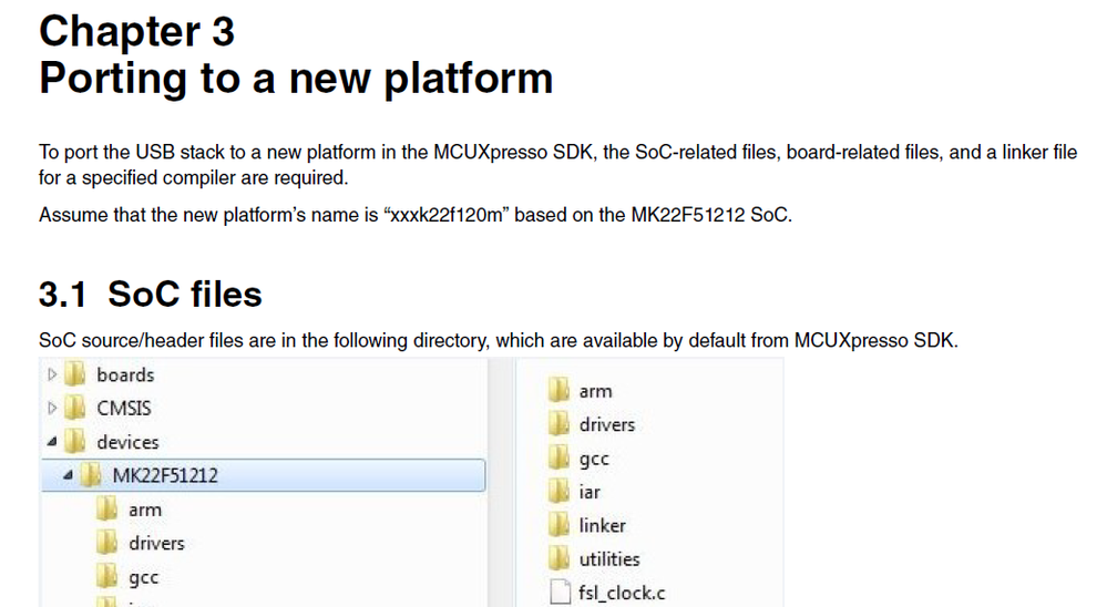

danielchen
Hi Ian Norman
I would suggest you refer to the MCUXpresso SDK User's Guide.pdf for how to do it.
This doc is under the installation folder
SDK_2.3.0_FRDM-K66F_doc\docs\usb\MCUXpresso SDK USB Stack User's Guide.pdf
I hope it helps.
