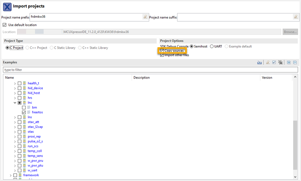

Hi Stephen, I hope you're doing well!
MCUXpresso imports and configures SDK example projects in different ways depending on the configuration when importing the project.
By default, the current MCUXpresso version (11.2.0) creates copies of the files used by the project and puts them in the corresponding workspace folder:
This should be creating copies of the source files instead of referencing the ones on the SDK.
Could you please try reimporting the project with this setting enabled and replacing the files with the ones you modified?
Please let me know if you have any further issues.
Sebastian

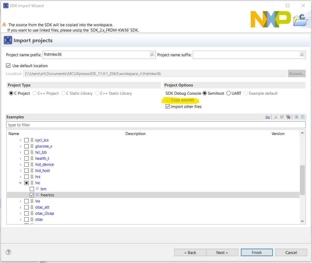

I'm using IDE 11.0 and am mid-way through a development project so don't want to change it unless I have to!
I import the examples from a .zip version of the SDK, so the files are copied by default, e.g.:
This results in a .cproject that includes the following references to the SDK components:
        <storageModule moduleId="com.nxp.mcuxpresso.core.datamodels">
        <sdkName>SDK_2.x_FRDM-KW36</sdkName>
        <sdkExample>frdmkw36_wireless_examples_bluetooth_lnc_freertos</sdkExample>
        <sdkVersion>2.2.5</sdkVersion>
        <sdkComponents>middleware.freertos.heap_4.MKW36Z4;middleware.wireless.framework.osa_freertos.MKW36Z4;middleware.wireless.framework.common.MKW36Z4;middleware.wireless.framework.osa.MKW36Z4;middleware.freertos.MKW36Z4;middleware.wireless.framework.flash.internal.MKW36Z4;middleware.wireless.framework.gpio_adapter.MKW36Z4;middleware.wireless.framework.keyboard.MKW36Z4;middleware.wireless.framework.tmr.MKW36Z4;middleware.wireless.framework.led.MKW36Z4;middleware.wireless.framework.reset.MKW36Z4;middleware.wireless.framework.mem_manager.MKW36Z4;middleware.framework.generic_lists.MKW36Z4;middleware.wireless.framework.messaging.MKW36Z4;middleware.wireless.framework.panic.MKW36Z4;middleware.wireless.framework.rng.MKW36Z4;middleware.wireless.framework.shell.MKW36Z4;middleware.wireless.framework.smgr.MKW36Z4;middleware.wireless.framework.smgr.i2c_adapter.MKW36Z4;middleware.wireless.framework.smgr.spi_adapter.MKW36Z4;middleware.wireless.framework.smgr.uart_adapter.MKW36Z4;middleware.wireless.framework.nvm.MKW36Z4;middleware.wireless.framework.module_info.MKW36Z4;middleware.wireless.framework.function_lib.MKW36Z4;middleware.wireless.framework.sec_lib.MKW36Z4;middleware.wireless.ble_host.MKW36Z4;middleware.wireless.ble_controller.MKW36Z4;middleware.wireless.ble_appl_main.MKW36Z4;middleware.wireless.ble_gatt_db.MKW36Z4;middleware.wireless.ble_gatt_service_discovery.MKW36Z4;middleware.wireless.ble_profiles.battery_service.MKW36Z4;middleware.wireless.ble_profiles.device_info_service.MKW36Z4;middleware.wireless.ble_profiles.location_and_navigation.MKW36Z4;middleware.wireless.ble_profiles.time.MKW36Z4;middleware.wireless.framework.coexistence.MKW36Z4;middleware.wireless.framework.linkscripts_KW36.MKW36Z4;platform.drivers.common.MKW36Z4;platform.Include_common;platform.drivers.clock.MKW36Z4;platform.drivers.lpuart.MKW36Z4;platform.utilities.debug_console.MKW36Z4;platform.drivers.trng.MKW36Z4;platform.drivers.flash.MKW36Z4;platform.drivers.gpio.MKW36Z4;platform.drivers.port.MKW36Z4;platform.drivers.tpm.MKW36Z4;platform.drivers.dspi.MKW36Z4;platform.drivers.i2c.MKW36Z4;platform.drivers.lptmr.MKW36Z4;platform.drivers.rtc.MKW36Z4;platform.drivers.llwu.MKW36Z4;platform.drivers.ltc.MKW36Z4;platform.drivers.pmc.MKW36Z4;platform.drivers.adc16.MKW36Z4;middleware.wireless.framework.dcdc_MKW36Z.MKW36Z4;middleware.wireless.xcvr_kw36z.MKW36Z4;platform.drivers.smc.MKW36Z4;CMSIS_Include;platform.devices.MKW36Z4_startup.MKW36Z4;frdmkw36_wireless_examples_bluetooth_lnc_freertos;</sdkComponents>
        <boardId>frdmkw36</boardId>
        <package>MKW36Z512VHT4</package>
        <core>cm0plus</core>
        <coreId>core0_MKW36Z512xxx4</coreId>
    </storageModule>
Which, as I said before, seems to be the root cause of my problem of the include paths being updated when I update the SDK.
Maybe this com.nxp.mcuxpresso.core.datamodels needs to be edited from within the IDE?
