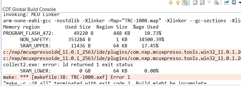

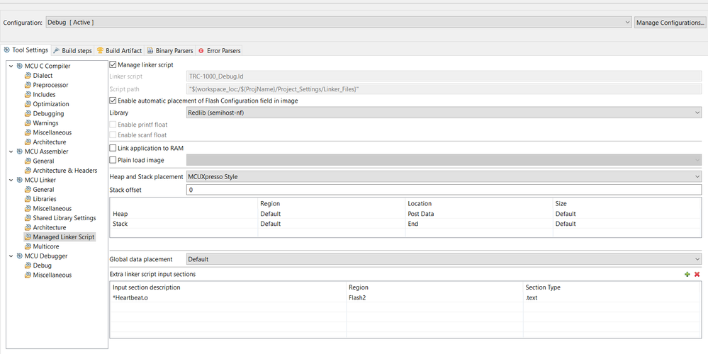

I am using MCUXpresso IDE for a project(MK22FN512xx) where I need to link code files in a specific section of the flash. I would really appreciate if someone could point me in the direction of where to look for it or even a step by step guide. I have tried adding a section in the flash(NON_SAFETY) via mcu settings and then in the input linker section i added a simple heartbeat.o file. Image belowpastedImage_1.png

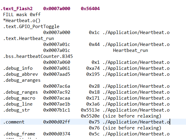

After this when I debug and see the map file, I can see the file is mapped to address I specified but the % usage looks way off the charts. pastedImage_2.png
Any help is appreciated. Thanks in advance.

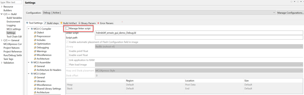

See the IDE user manual:

anishvenkataram
Hello Erich,
First of all, I would like to thank you for the data you post on your website. Your website came to my rescue yet again. I read your post on "Putting Code of Files into Special Section with the GNU Linker" for KDS. I tried it and it gave me a lot of confidence and I was able to replicate the same procedure on MCUXpresso. It works perfectly now.
