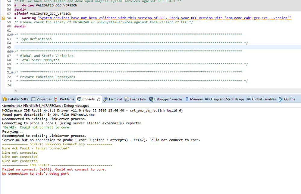

louis_eeckeloot
Thanks, I solved the problem on my board with increasing the power supply.
However, I have another error when I'm debugging a program on MCUXpresso IDE on the development kit OM27462CDK.
this error appears when I launch the debug :
I tried to update the user EEPROM but it didn't correct the problem.
Do you know what is the origin of this error and how to resolve it ?
BR,
Louis.
10,761 次查看
IvanRuiz
May I ask if you are debugging it through LPC-Link 2? -if so, please make sure that the cable is properly connected to the board's connector. Have you tried flashing an unmodified example of the reader's Library? Please share your results and more information about the project to be flashed.

louis_eeckeloot
Yes, I debug it through LPC-Link 2.
Yes it's well connected to the board's connector.
yes, I tried to flash an unmodified example which i have uploaded from PN7462AU_FW_v05.21.00_Full
I try to flash NfcrdlibEx4_MIFAREClassic and there is the result i have:
10,761 次查看
IvanRuiz
Could you please send us your project through the case you submitted regarding this error (00227615) to analyze the project properties?
