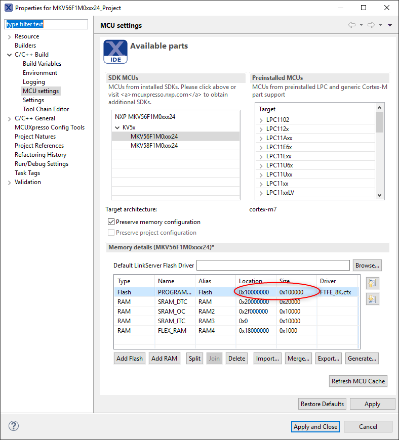

Now i want to add memory configuration as parameter while building the project.
I MCUXpresso IDE the default setting for MKV56F1M0xxx24 is as below
While this is possible in the IDE, I want to provide this setting as a parameter while building the project through command line, which in my case is a batch file. Is it possible to do so??

It is not possible to do this from the command line. if you want a different memory configuration you have to change your project, or have 2 projects

If I create two Projects, when I do a change i source code, i need to replicate the same for other project as well.
So, is there an option that i change the memory configuration of a project without using the MCUXpresso IDE. I mean, what are the files that store the project settings, mainly memory configuration.
By this, i can use a script to trigger two builds. Before triggering the second build, the script shall modify the project setting or configuration file for new memory configuration.

have a look at the .cproject file: here all the options and settings for the compiler/linker/etc are stored.

That helped...
