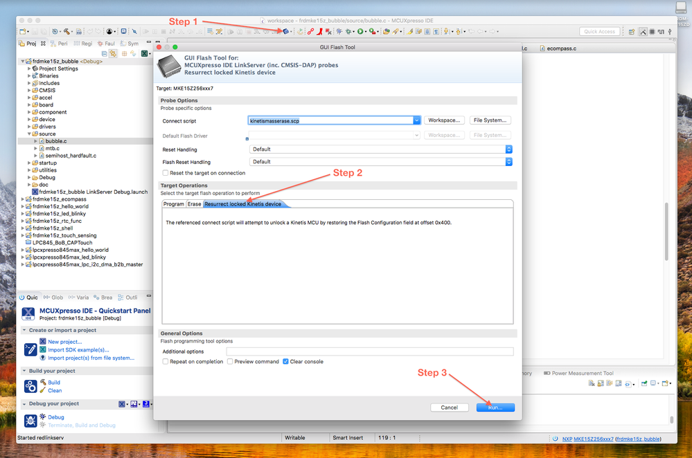

I found the problem was that the MCU was locked, It's a simple way of unlocking a MCU in MCUXpresso that I thought I'd share with other novices so they can get going again easily:
Step 1: Open the GUI Flash tool
Step 2: Choose Resurrect locked...
Step 3: Hit Run.
In a moment the MCU will be unlocked and ready for more programming action!

I used i.MX RT1052, My xpresso IDE > GUI flash tool didn't have any 'Choose Resurrect lockedGUI flash tool '

rico1
Tried it but didn't work...
I installed the J-link firmware and everything worked. It gave a message about some security readout function 0x400 I think. I could overwrite this and I re-flashed the DAP firmware and it worked... So there was some protection enabled.
So if anyone experieces these problems maybe this will help ;-)
